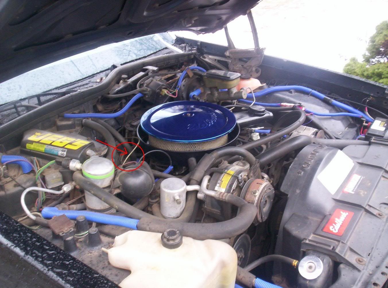

 Another thing i noticed, i managed to break what looked like a 'tan - colored' plastic vacume line that goes from behind where the shock absorber is to a little canister device mounted just above the valve cover.
 Pictured here...
I blocked the line to see if i heard the noise stop and diddnt notice anything, i even tried rigging it back together with electrical tape, nothing changed.
 ideas?

Quote:  did the alternator belt, distributer cap, rotor, and wires this afternoon .......  Alt belt was to address a problem.  The others were not.  Always best to focus on the problem only, until it's rectified. Quote:  ........ Still hearing a clicking sound ........  And you will, until you address that problem.   Quote:  ........ a leak? meaning the plug could be loose? ........  Yes, that is the next step.  I was thinking crossthread, but it's unlikely. since your access is limited.  Easier to fix if it's loose. Plug threads should be lightly oiled, then screwed all the way in by hand.  If no gasket is used, very little movement is needed to torque it.  If a gasket is used it should take less than a quarter of a turn. Quote:  ........ i managed to break ........  plastic vacuum line........
I remember dealing with that line once, don't remember anything else about it.  Not related to to the noise problem.  Check where it starts and ends,  Might tell you what it does, and why it's there.
