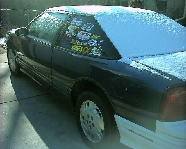

What do you do when your best friend (AL) wants his 1994 2dr Cutlass Supreme to go faster (besides decking/porting the heads and putting ported 3400 upper and lower intake on the 3100) and you have suddenly acquired a 90 Olds Toronado Trofeo (for free)? I'll tell you:
You fire up your plasma cutter remove the engine/tranz/subframe and front strut buckets from the Trofeo then you proceed to remove the harness and ECM/BCM etc. from it also (LOTS of "useless" gismo's on the Trofeos)
Then you take the Cutlass gut it and tube cage the back half of the car while removing everything (not required) with PLASMA cutter (one of my best investments).
To make it short, weld in the front strut buckets from the Trofeo in the (old) rear strut position and build outriggers from the cage to bolt the front Trofeo subframe into the rear of the cutlass.
Bolt in the 3.8L v6/Tranz into the subframe and lower car back onto the subframe load in the 15 Gal fuel cell and Aeromotive pump and an-6 and 8 lines (so he can drive it while I reduce the Trofeo's harness to the essentials and make a VATS/PassKey simulator for the ECM)
Find out that the (now) much larger rear brakes will lock em up and install Adj. proportioning valve!
After I finished the harness (Al is horrible at electronics) I eliminated 53 lbs of a 65lb harness and made a signal generator (30Hz ground pulsed) to simulate the OEM VATS signal so that engine will run without killing injector pulse--Anti theft. We installed the rear battery (more room up front for ram air) and ran the main power/ground and got to listen to the sweetest sounds!
TWO V6's with open exhaust!
We have finished the dual shifters and the rear throttle cable/axleshafts etc. and put a Flomaster on the front engines ex. (fits great where that d**n Cat once was!) and then we went for a ride!
Where the front used to just unload and spin the tires now it does it but the rear squats and GOES! What a difference!
We are planning to go to Byron IL dragaway when I get back to IL from helping my Grand parents move from in CA to TX.
But Al has to finish the new console and door panels interior stuff we had finished the rear (removable) firewall but he is doing the finishing touches while I am away. He is making it look like a GIANT Subwoofer box complete with fake speaker grills! This will (hopefully) make the tech inspector not notice the rear engine and think she is all STOCK! I can't wait to get back to working on her!
She will always be a work in progress and I have to post my pictures (have to have him Email me the pics first out here!) so that you can see it is truly a homebuilt 94 442 (400(total) hp-4 wheel drive-2(twin) engines)
Future mods include a T04 turbo for the 3.8L (and maybe Nitrous) to help push her off the line, and a DIY EFI MegaSquirt v2.2 ECM to control it at that point (costs the same and is much more tunable than a JET chip)(uses Assembler and even has shareware to use a Windows based fuel map adjuster!)
That first ride with both engines had us grinning ear-to-ear more than enough to make us want to do it again with maybe a twin engined Pontiac GTP!

well here are some new pics of Al's and I's project, the 94 442 Olds (400 Hp (total)-4 wheel drive-2 (twin) engines)
we are hoping to be finished with all the interior work by the begining of racing season so he can race me in my 74 Nova,
long live lowbuck/redneck hot rodding!
this is the rear engine (3800 S1) bay (view from behind the drivers seat) with the new radiator/cooling fan
the front engine of course-3100
this is the rear engine bay (view from the trunk) with the harness installed and the new throttle & shifter cable (a 14 ft Morse Cable cost's $$$$ lol)
the Bada$$ 100psi Aeromotive fuel pump for both engines (4 port regulator with 2 xtra ports for future N20 and Turbocharger fuel enrichment feeds
the later model roller rocker heads for the front 3100 engine-right now undergoing porting and undercut valves to replace the friction rocker heads on the front engine now
and a rear 3/4 shot with a little of the dual exhaust rear bumper (from 3400DOHC convertible) to look good for each engines exhaust tip
Al and his brand new axle shafts fer the rear engine/tranny (we drove it with the shot stock axles so these should make allot less noise lol)
and yet another pic this of both the tranny shifters-we have found a way to weld them side to side with vertical handles for easier opperation
we will be doing another twin engine vehicle soon (87 Lebaron GTS-2.2L turbo), and who knows we might start doing more of em.
well what do you think?

Joined: Mon Feb 16, 2004 4:44 pm
Posts: 269
Location: Lees Summit MO
I read about a twin engine 70s era Toro with two 455s, one front and one back like your setup. 4WD and all that just like yours. Anyway, they got real smooth acceleration because there is no way except luck that both would shift at EXACTLY the same time. The driver reported that the feel was awsome because it was constant acceleration with no lurching or anything, maybe you guys can expect the same kind of performance :D
'46 sixty series 2 dr fastback
 Post subject:
PostPosted: Tue Jan 18, 2005 1:59 pm
Joined: Wed Aug 18, 2004 12:53 am
Posts: 326
88delta88 wrote:
awesome... I dont know what to say except I wish I were there to see this thing in action!
Wow... Hey can you do front AND rear burnouts in opposite directions at the same time??? :-)
already have :wink: front engine in D and the 3800 in R and a bit of bleach/dawn on the wetted down road the 3800 pulled it backwards after the front engine upshifted and took him out of the puddles-talk about a jolt! we should have wetted down the whole street or waited fer rain but....... why wait.
it was during our first test drives that we noticed that the stock toronado halfshafts were pretty wornout nut with the new ones there should be less slack in the driveline, less jolting LOL
we do want to get a D&R burnout on video though! maybe even put the front into R andthe rear into D lol make it a compact car LOL (dont think that it could do anything with the 2x3 inch subframe rails/cage lol)
